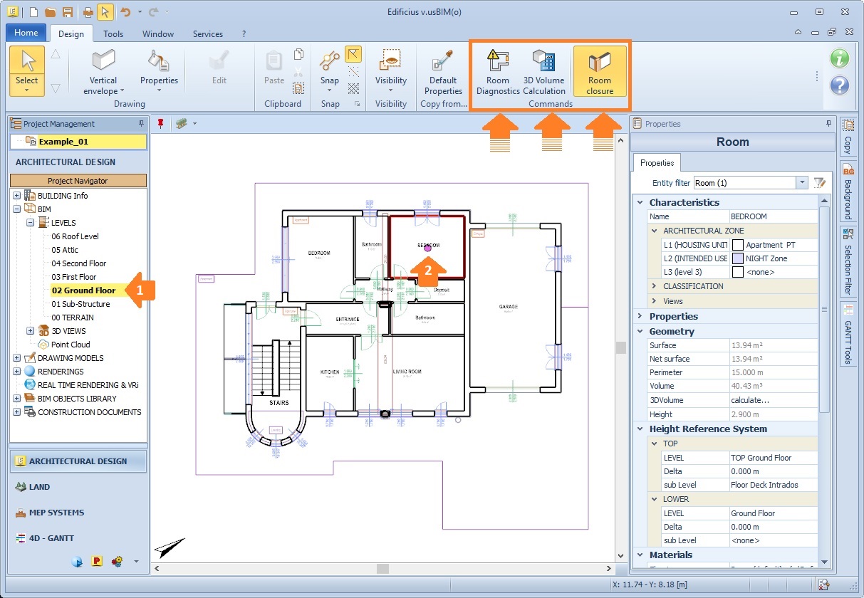

With the update to the new "usBIMe" release of Edificius, a new "Commands" tool has been added for the "Space" object. To enable it, select a Space on a level or in 3D (click HERE to view an image).
Within this tool, you'll find the following commands:
- Space Diagnostics - a new and more powerful diagnostic tool related to space enclosure;
- 3D Volume Calculation - calculates the volume of the space, checking for any inconsistencies;
- Space Enclosure - activating or deactivating this allows you to include or exclude columns from the space's perimeter enclosure.
In this discussion, let's delve into the "Space Enclosure" command.

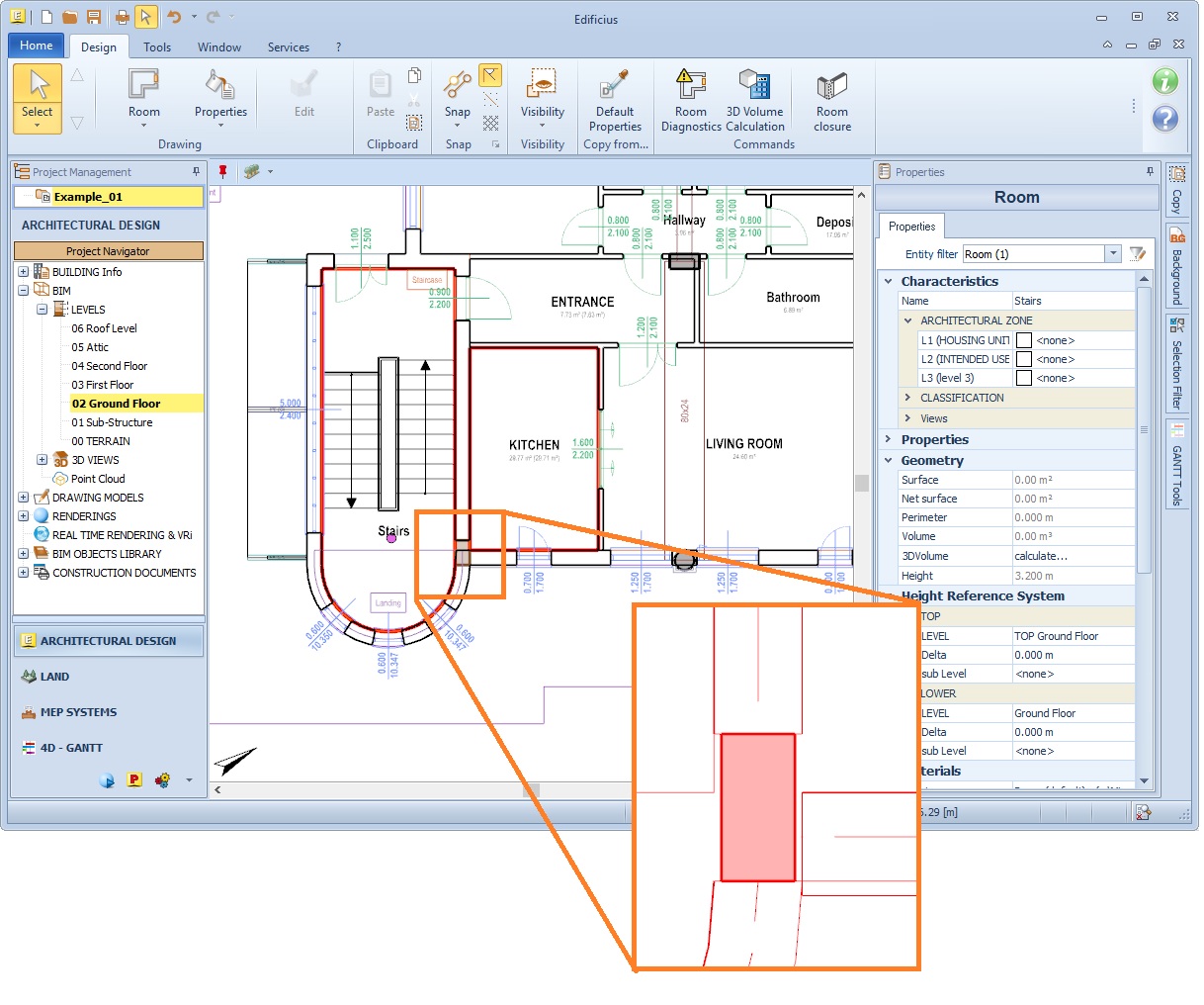

However, there is an exception to this rule. With the ACTIVE command and modeling as in CASE 2 (i.e., stopping the envelopes at the edge of the columns), if there are columns with "special" and/or "irregular" geometric shapes on the space's perimeter, Edificius will exclude these columns from the space enclosure. As a result, the space will remain open. A red polyline will indicate the space's perimeter, clearly showing the point where it remains unenclosed. This point will coincide with the irregular pillar (click HERE to see an example image).
