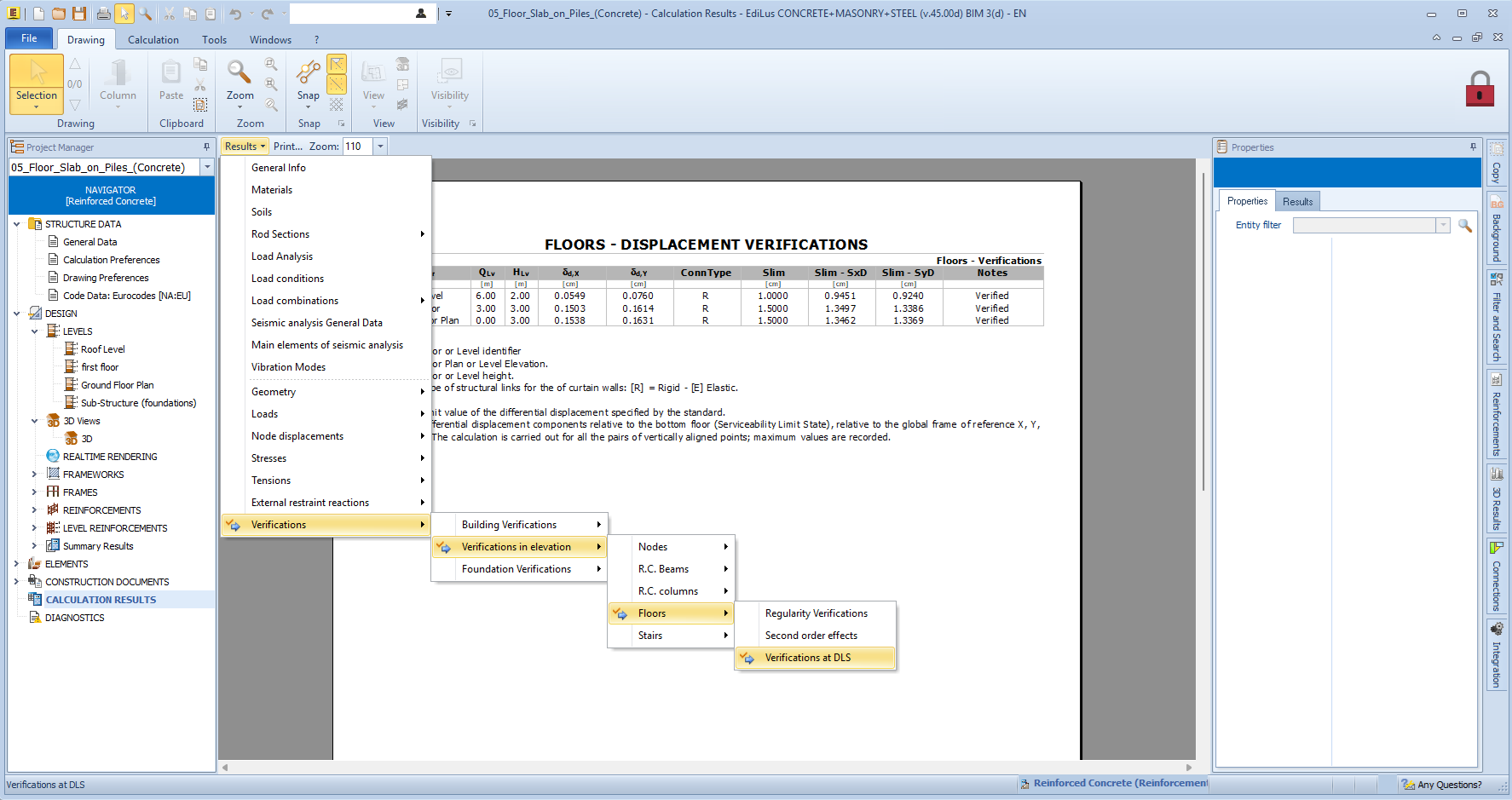

Such verification is automatically performed by the program.
Click HERE to see an explanatory image of the verification table.

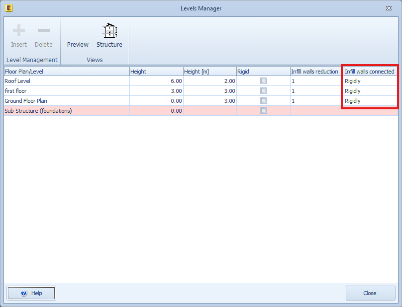

In the Level Management, the last column allows you to modify the type of infill that interacts with the structure (click HERE to see explanatory image).

The in fill connection works only when you add infill walls in the model?
AntonioDL
AntonioDL 2026-01-27 10:36:47
klejdin
No, the check is performed regardless of the presence of the infill walls.
