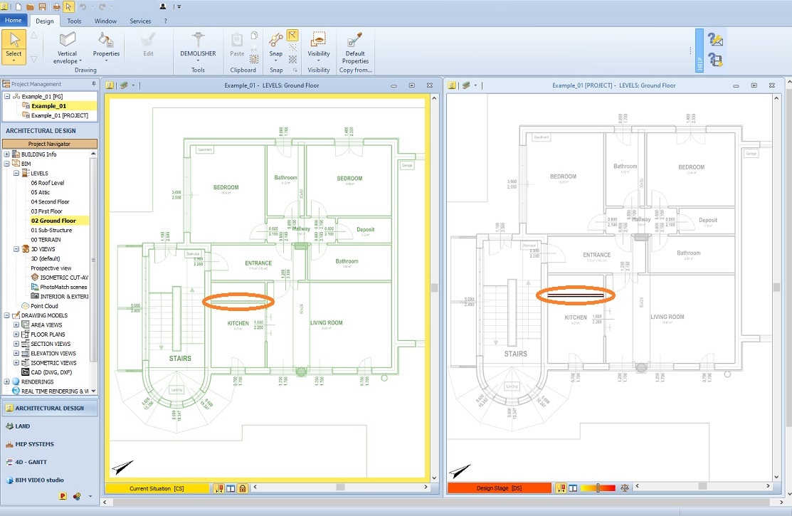

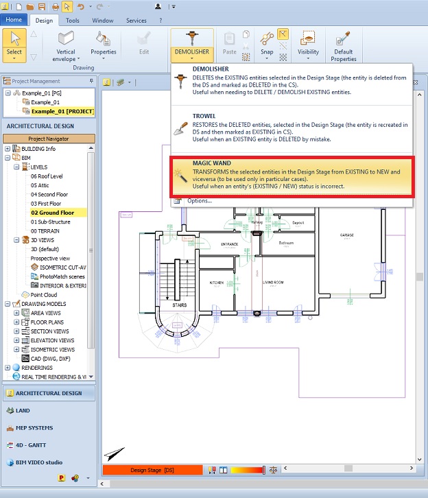

How does the Magic Wand tool work in the Project Status file of a Project Group?
Answer:
The magic wand, in the Project Situation, corrects the status of the entity from existing to new and vice versa.
The magic wand tool in the Project Status file of a Project Group should be used if the entity’s status is not correct, changing it from EXISTING to NEW or from NEW to EXISTING.
