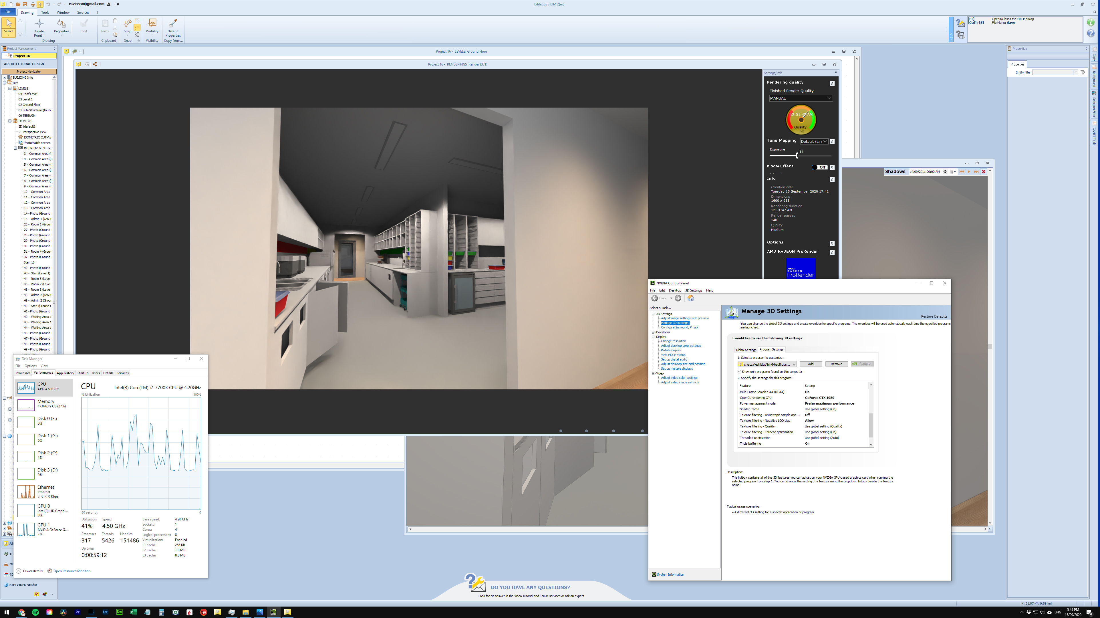

User_1150617 | User_1150617 2020-09-15 09:48:10 Hi Tony, thanks for your help. I've tried almost everything but still there is no difference to the rendering performance. I've attached 2 screenshots here. I'm grateful that you are helping me out. Thanks 630750_1600156039_acca_2.jpg |
Tony | Tony 2020-09-15 10:10:23 If you are using a Laptop, you can also try setting your Battery Power usage to "High Performance". Most Laptops will only use the Onboard GPU if these options are set to Paving Saving mode. However, I would also recommend tryying to update your Video Card Drivers too. Regards |

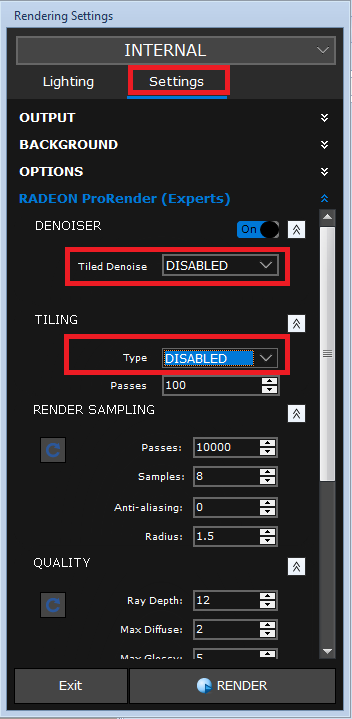

Tony | Tony 2020-09-15 15:44:40 Hi, Thanks for sending in your file. When moving on to the rendering process, it's always a good idea to only have the lights in the scene you are rendering on. Before proceding to your next render, you can then switch those lights off and switch on the lights that you need in your next scene. I would also use Emissive Material to simulate your LED Spotlights (see attached video). It gives a completly different effect and also brings in a little more realism. A further suggestion would be to always use Materials on your objects (furniture, walls, etc). These are necessary especially when doing interior design renders and good for simulating the true behaviour of artificial lighting indoors. Please also disable the TILING option in your Rendering settings - this is necessary only when using Low Performance cards and with limited Video Memory. You should notice an improvement in duration. As with the CPU/GPU usage - You will definitely see a CPU usage during initial scene creation and when the rendering launches the Denoising threads. AI denoising is CPU based when not using an AMD video card. Please also enable the IBL lighting and choose from one of our HDR backgrounds.. These work great because not only do you have a relaistic background but the lighting information is also used to Illuminate your scene and all natural lighting blends better into your Rendering. See these videos: For Background settings: video.accasoftware.com/EN/edificius/id877/index.html?idPLV=13209&autoplay=1 Rendering settings: video.accasoftware.com/EN/edificius/id877/index.html?idPLV=13216&autoplay=1 Dealing with lights and groupings: video.accasoftware.com/EN/edificius/id461/index.html?idPLV=8224&autoplay=1 See this screenshot to learn how to disable Tiling features See this Video that shows how to set Emissive materials and how long it takes to render one of your interior zones. Hopefully this should help! Regards |
User_1150617 | User_1150617 2020-09-15 17:27:01 wow Tony! Thank you so much for your recommendations! I didn't know we can light up the LED lights using Materials. I've tried a few things and the rendering is so much more realistic. CPU utilization has reduced a little bit to 40% instead of 80%. GPU utilization has gone up from 3% to 20%. From what I can see, I don't really need to upgrade my PC unless I want more CPU cores to reduce rendering time. The WX 9100 that you have isn't being fully utilized when rendering which is a surprise to me. I thought it would go up to 90%.
