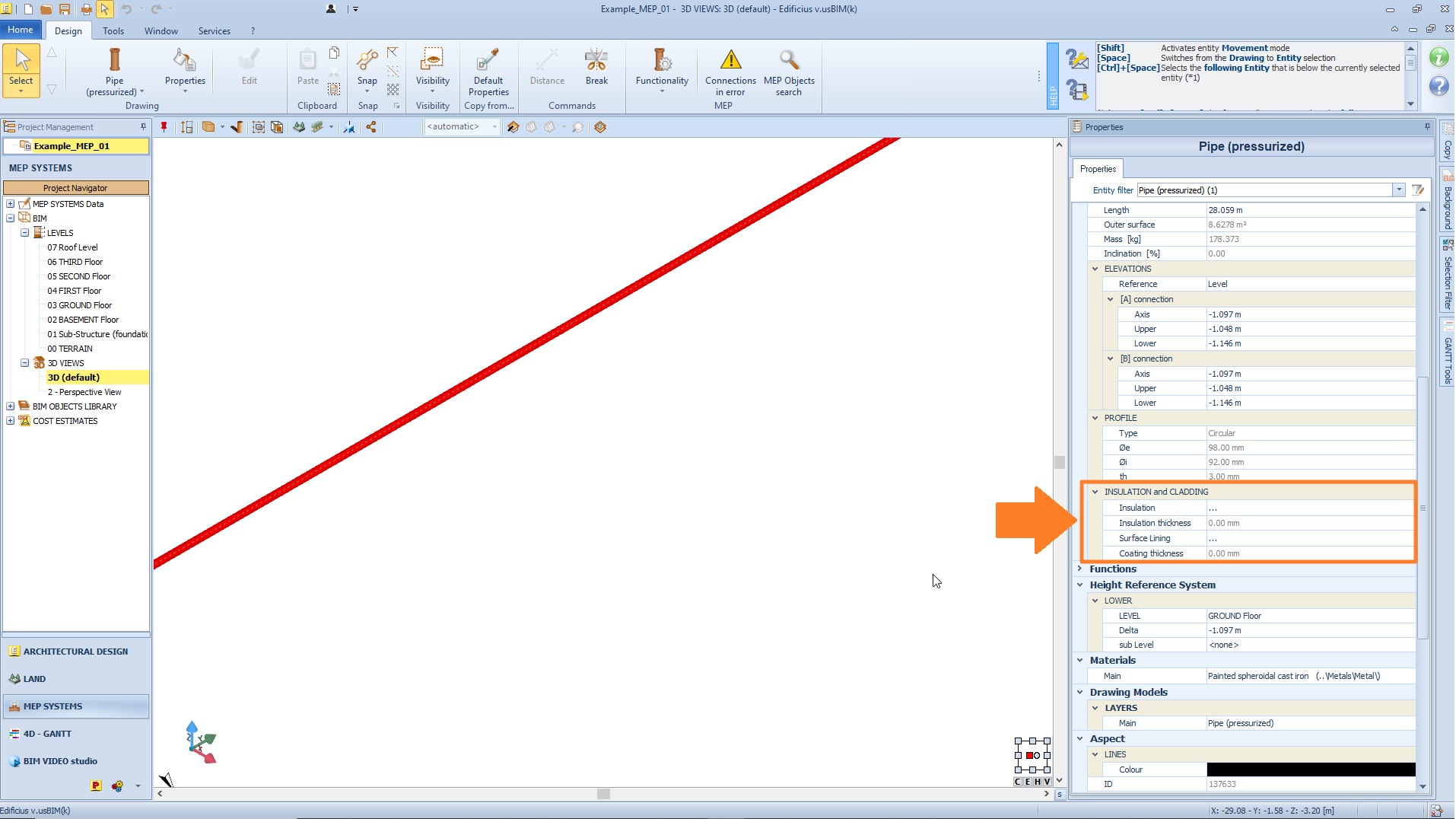

We need insulation for piping how can we draw. How can we draw insulation in 3d modeling

To add insulation to a pipe we simply need to:
1_ design the pipe;
2_ select the pipe;
3_ from the Properties Toolbox add the insulation with its properties.
Please, see the attached explanatory image --> INSULATION and CLADDING.png.
